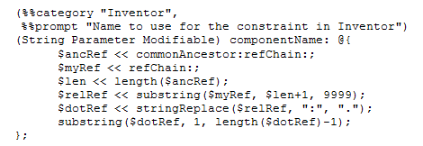

Language-building rules
Rules which build language elements are not able to be converted. Such rules typically consist of string literals being combined with computed strings. The results are then supplied to Intent as language source. All such rules must be converted to the new syntax. For example:
Syntax-specific rules
Users sometimes use string search functions to parse language elements, like reference chains. Since the syntax of reference chains has changed, these rules will fail.
