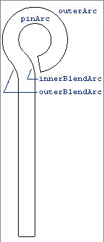

| Name: | Arc_Ex04 | |
| Design: | acDrawingDocument | |
| Name | Type | Formula |
| PlateThickness | number | 0.125 |
| PinRadius | number | 0.125 |
| BendRadius | number | 0.25 |
| PlateWidth | number | 1.5 |
| Child Name: | BottomLine | |
| Child Design: | :Line | |
| Name | Type | Supplied |
| thruPoint1 | point | Me.origin |
| thruPoint2 | point | Me.origin + Vector(PlateThickness, 0, 0) |
| Child Name: | PinArc | |
| Child Design: | :Arc | |
| radius | number | PinRadius |
| center | point | Point(PlateThickness, PlateWidth, 0) |
| startAngle | number | 280 |
| endAngle | number | TrimTan(Me.Child, InnerBlendArc) |
| Child Name: | OuterArc | |
| radius | number | PinArc.radius + PlateThickness |
| center | point | PinArc.center |
| endAngle | number | TrimTan(Me.Child. OuterBlendArc) |
| Child Name: | OuterBlendArc | |
| radius | number | BendRadius |
| tanArc1 | part | OuterArc |
| inside1 | boolean | False |
| onRight1 | boolean | False |
| tanLine1 | part | LeftLine |
| onRight2 | boolean | True |
| endAngle | number | TrimTan(Me.Child, OuterArc) |
| Child Name: | LeftLine | |
| thruPoint1 | point | BottomLine.startPoint |
| dirVector | vector | Vector(0, 1, 0) |
| end | number | TrimTan(Me.Child, OuterBlendArc) |
| Child Name: | InnerBlendArc | |
| tanLArc1 | part | PinArc |
| tanLine1 | part | RightLine |
| endAngle | number | TrimTan(Me.Child, PinArc) |
| Child Name: | RightLine | |
| thruPoint1 | point | OuterArc.startPoint |
| end | number | TrimTan(Me.Child, InnerBlendArc) |
| Child Name: | TopLine | |
| thruPoint2 | point | PinArc.startPoint |
