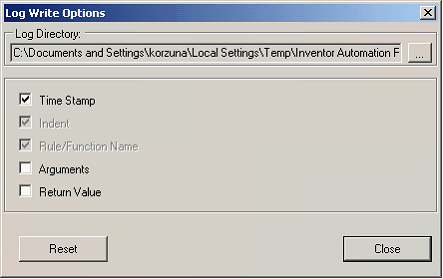

Log Write Options control the scope of the data written into log file.
