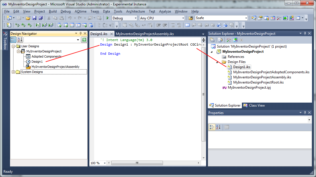

The Design Navigator exists in Visual Studio is essentially the same as it is in Design Editor with some exceptions. The biggest difference is that the User Designs reflect the Project File loaded in the Visual Studio Project. One exception to that workflow is that Inventor has support for including other Inventor Projects as valid locations to find Designs. In this case, you will see the referenced Designs in User Designs, but you won't see those in your project.
The rest of the Design Navigator features should work as they do in Design Editor, for example, as you add/remove Designs the Design Navigator will update accordingly. The context menu has commands for opening the design, inserting the design, etc.

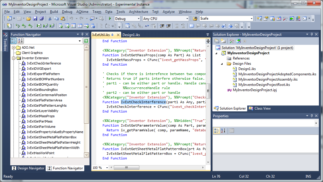

As with the Design Navigator, the Function Navigator should work as you expect. The exceptions and details of how it works are similar to the Design Navigator.

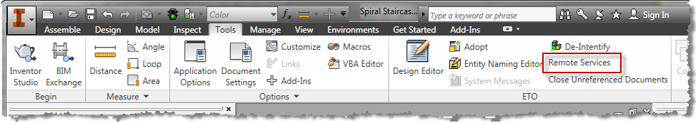

This window is different that the Design/Function Navigator in that a running host is required. Currently Inventor is the only supported host. If Inventor is running, and has an Intent Model available, and Remote Services is on, then this window will display the active Intent Model from Inventor. This browser is primarily read-only.
