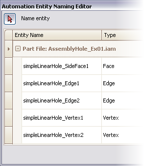

Assembly Feature Entity Naming
There is an automatic entity naming mechanism for IvAssemblyHoleFeature. The illustration shows the automatically-applied entity names as viewed in the Entity Naming Editor.
