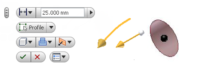

The in-canvas display is overlaid on the graphics window to support Direct Manipulation operations. It typically contains a mini-toolbar featuring command options, manipulators, and a value input box. The mini-toolbar enables direct and predictable interaction with the 3D model. OK and Cancel buttons at the bottom of the in-canvas display confirm or cancel an operation.
The value input box at the top of the mini-toolbar specifies numeric values for modeling and editing operations.
The mini-toolbars display in-canvas close to a selected object in the graphics window. They provide quick access to frequently used commands and command options, and buttons to confirm or cancel the current operation. The button flyout menus display command options, where appropriate.
