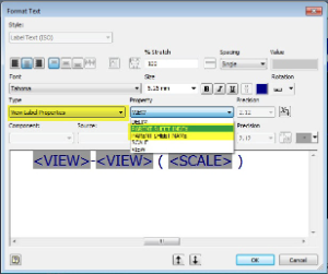

Identify drawing view associative sheet reference in View Labels
You can easily find the right sheet when Cut Views (Section/Detail) are moved to a different sheet. View Label Properties now include PARENT SHEET NAME and PARENT SHEET INDEX. The string value updates when the parent view is moved to a different sheet, or when sheet name or index is modified
You activate these properties when you add or edit a view label, and select <PARENT SHEET NAME> and <PARENT SHEET INDEX>.

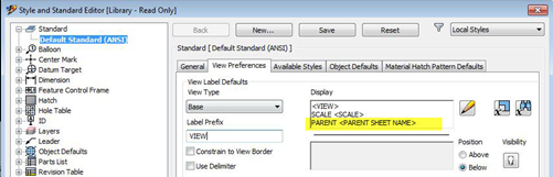

The property is also added to the default view label in the Style and Standard Editor Standard View Preferences Display.
