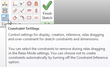

Improved access to 2D sketch constraints settings
All 2D sketch constraints-related settings are reorganized into one new command called Constraint Settings.
The new setting Display constraints on creation provides clear feedback on the constraint as you create it.
The new setting Show constraints for selected objects highlights constraints for geometry that you select in the graphics window. When displayed, you can select any constraint to delete it.
