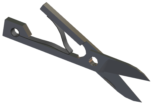

Display quality set to smoother.

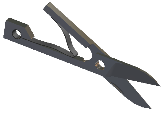

Display quality set to rough.
