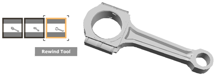

As you use the navigation tools to reorient the view of a model, the previous view, along with a thumbnail is saved to the navigation history. A separate navigation history is maintained for each window; it is not maintained after the window is closed. Rewind navigation history is view-specific. Rewind history is not saved between sessions.
When you hold down the button on the pointing device over the Rewind tool on the wheel, the Rewind History panel displays. You can scroll through the navigation history. To restore one of the previous views in the navigation history, drag the bracket to the left in the Rewind History panel.
Restore the previous view
  1. Display a wheel.
  2. Click the Rewind wedge.
Note: You can also press F5 to restore the previous view. Continue to press F5 to restore the previous views.
Restore a previous view with the Rewind History panel
  1. Display a wheel.
  2. Click and hold the Rewind wedge.
    The Rewind History panel displays.
  3. While holding down the button on your pointing device, drag to the left or to the right to restore a previous view.
    Dragging to the left restores an older previous view. Dragging to the right restores a view that is newer than the one you are currently viewing. You must have previously used the Rewind tool to see views available on the right. The current position in the navigation history is indicated by the orange box dragged along the Rewind History panel.
