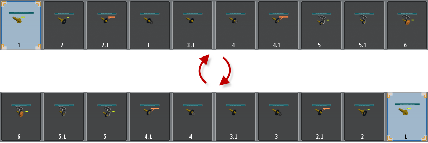

Reverse storyboard is a one click process where an entire storyboard can be reversed. Build a storyboard where a complete assembly is exploded into separate components. With the reverse storyboard create a storyboard on how to assemble the assembly.
Command Access:
Right-click any storyboard in the storyboard editor select Reverse Storyboard from the context menu.
