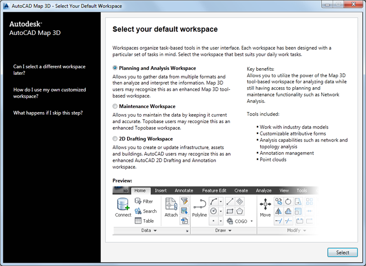

Workspaces
AutoCAD Map 3D comes with predefined workspaces. Each workspace organizes and displays commands and toolbars differently. When you first start AutoCAD Map 3D, you are prompted to choose your default workspace.
To change your default workspace
  1. Click Help tab > Understand The User Interface > Select Workspace .
  2. Select a different default workspace.
    The next time you start AutoCAD Map 3D, you will see the new default workspace.
