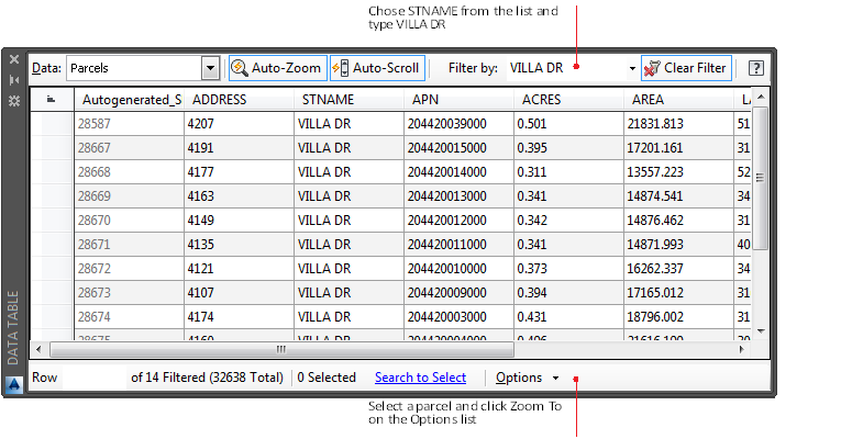

Display the Data Table for any layer. Filter the Data Table to show a subset of parcels—in this case, only parcels on Villa Drive.

To use the Data Table to filter features
Open
Drawing. Do not spell out the word “Drive.”
Use the Data Table to filter the parcels you see.
This button is outlined when it is on.
Scroll the Data Table to the left to see the left-most fields.
AutoCAD Map 3D zooms to the selected parcel.
You can do a more sophisticated search. Click
. Find That option lets you query a layer with a Boolean condition—for example, ACRES > 1 to find parcels that are larger than an acre. The map then shows only the objects that match your query.
