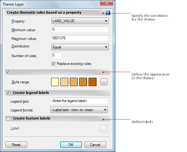

To define the theme
  1. In the Theme Layer dialog box, under Create Thematic Rules Based On A Property, click the down arrow next to Property and select LAND_VALUE.
    Leave the minimum value, maximum value, and distribution settings as they are.
    Use the Theme Layer dialog box to design your theme.
  2. Click next to the illustration of the Style Range.
  3. Select the fill element.
  4. Change the final color in the color ramp to a dark red.
  5. Change the Transparency to 40.
  6. Click OK twice to return to the Style Editor. Leave the Style Editor open for the next exercise.
