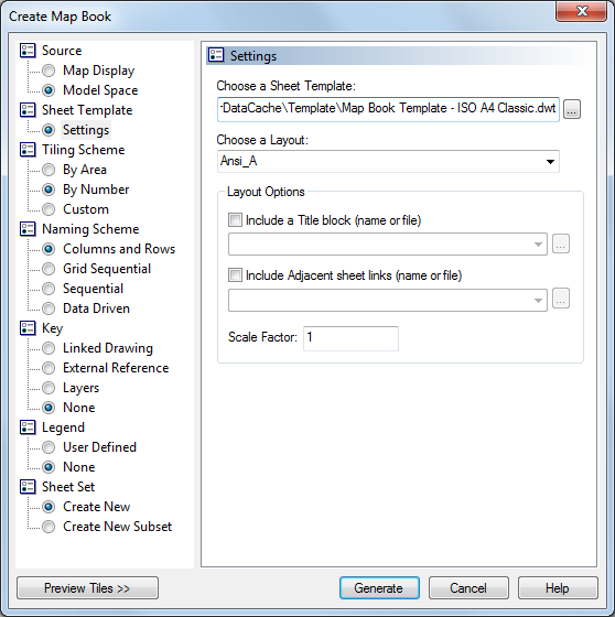

  3. Switch the Task Pane to Map Book and click NewMap Book.
    Each item on the left displays settings on the right.
  4. In the Create Map Book dialog box, for Source, click Model Space. Optionally, change the Map Book Name.
  5. For Sheet Template, do the following:
    • Click Settings.
    • Click the browse button for Choose A Sheet Template and navigate to the saved template you created (Map Book Template - Inset.dwt).
      If the dialog box does not display the templates directory, navigate to C:\Documents and Settings\your_name\Local Settings\Application Data\Autodesk\AutoCAD Map 3D 2015\R18.2\enu\Template.
    • Leave the layout set to Ansi_A.
    • For Layout Options, check Include A Title Block (Name Or File) and Include Adjacent Sheet Links (Name Or File).
    • For the title block , click the down arrow and click Title Block. For adjacent sheet links, click the down arrow and click Adjacent_Arrow_4.
    • Set the scale factor to 5000.
      Note: If you do not set the Scale Factor, the map book will comprise a large number of tiles . Be sure to set it to 5000.
