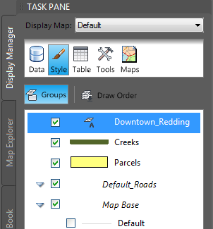

  1. In the Display Manager, select the new "Downtown Redding" text layer.
    Notice that a new Text Layer tab appears in the ribbon when you select a text layer. You use this tab later when you check in your changes to the text layer.
  2. In the Task Pane, click Style.
    Click the text layer and click Style.

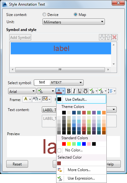

  3. In the Style Editor, click the cell under Style.
  4. In the Style Text Layer dialog box, make the text bold and a dark red color.
    These values provide the defaults for any text layer instances you add. You can override the defaults for an instance when you insert it.
  5. Click Apply and Close.
