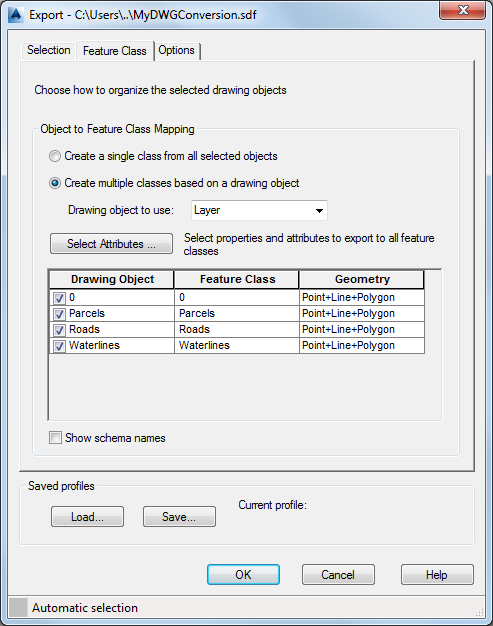

  1. In the Export dialog box, on the Feature Class tab, click Create Multiple Classes Based On A Drawing Object.
  2. For Drawing Object To Use, select Layer.
    The table in the dialog box updates to show the layer names and feature class names to use.
  3. celar the chock box for layer 0.

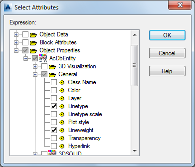

  4. Click Select Attributes.
    Attributes you specify here are assigned to every feature class in the SDF file. So select only attributes that are appropriate for all. For example, you can select general properties, which include things like Lineweight, but not object data properties, which are specific to each feature class.
  5. In the Select Attributes dialog box, expand the Object Properties item and the AcDbEntity and General items.
  6. Select the boxes for Lineweight and Linetype and click OK.
    Expand the parent items to select a subset of properties.
  7. In the Export dialog box, in the grid area, click the Feature Class cell for the first layer, Parcels.
    A button appears at the right side of the grid cell.
  8. Click for the Parcels Feature Class cell.
  9. In the Feature Class Property Mapping - Parcels dialog box, click Select Attributes.
  10. Expand the Object Data item and select Parcels.
    The resulting Parcels feature class has the object data fields for the Parcels layer, but not for any other layer.
  11. Click OK twice to return to the Feature Class tab.
  12. Click in the Geometry cell for Parcels and change the entry to Polygon.
  13. Repeat steps 6 through 11 for the remaining two feature classes, using the following table as a guideline.
