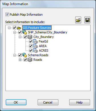

If you expand the list all the way, you can see the properties associated with the features in this map.
All subitems are automatically checked.
The Map Information dialog box determines which data is published to DWF
Optionally, you can select just a subset of the properties.
