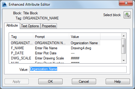

  1. Double-click the frame of the title block to see the Enhanced Attribute Editor.
    You can change any property of the title block
    Note: The title block is the lower part of the block on the right side of the layout. If you double-click a viewport within the title block by mistake, right-click inside the viewport and click Minimize Viewport.
  2. Change the organization name.
    ORGANIZATION_NAME is a text field whose default value is “Organization Name.” You can replace this default value by typing a different one.
    • Click the Attribute tab and click the ORGANIZATION_NAME field.
    • For Value, type the name of your organization.
    • In the Enhanced Attribute Editor, click Apply.

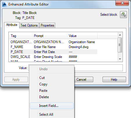

  3. Change the plot date entry.
    P_DATE (plot date) is a variable that can update automatically, based on a field. In this example, you set P_DATE to the date that the drawing was last revised.
    • Click the Attribute tab and click the P_DATE field.
    • Right-click the Value field at the bottom of the dialog box (which currently contains the value "---") and select Insert Field.
      Right-click the value to insert a field.
    • In the Field dialog box, under Field Names, select CurrentSheetRevisionDate.
    • Under Format, select Title Case.
    • Click OK.
