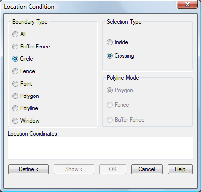

To combine location and property conditions in a query
Objects that cross the circle you draw are added to the drawing.
Define the circle for the selection.
Objects that cross the circle are queried into the Redding drawing. Because the query mode is Draw, the objects are copied into the Redding drawing.
