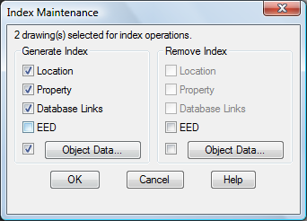

To create an object data index
Select all the options on the left except EED.

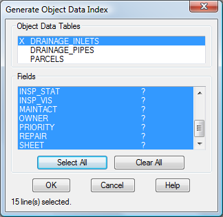

Select a data table, then select its data fields.
The indexes are created. As you work with your drawings, repeat this procedure periodically to update and recreate the indexes.
