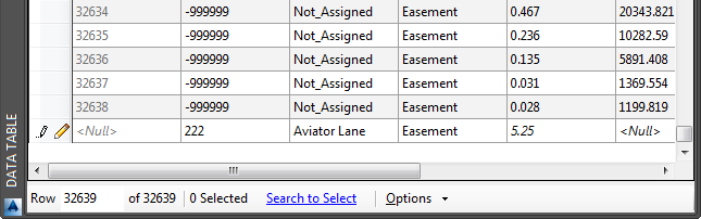

In the Data Table , add information about this parcel.

To add information about the new parcel
The original data source is updated.
If the Data Table is minimized or docked, click its Show/Hide icon to display it. Scroll to the bottom of the Data Table to see the new entry.
Look at the other entries to see what a logical entry would be for each column. Making changes to the parcel properties checks the parcel out automatically.
The original data source is updated with your changes.
You have added a new parcel and updated the parcel data to reflect your changes.
A new Data Table entry
