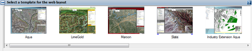

  2. In the Select A Template For The Web Layout pane, click a template thumbnail.
