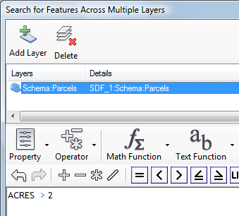

  2. In your map, select the feature layers and select the search command.
  3. To add more feature layers to the data being searched by the expression, click Add Layer and select the layer to add. To delete a layer, select it in the list and click Delete.

      Add layers and specify the expression for the search.
