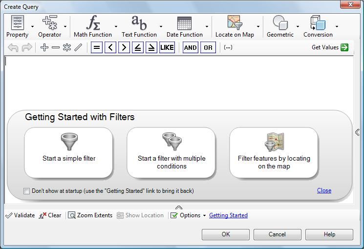

Overview of Expressions for Geospatial Features
An expression is the part of a query that specifies its conditions. A query evaluates data and returns only the subset of data that meets the conditions of the query.
For example, you can create an expression that specifies all parcels whose area is larger than 4000 square feet. A query containing this expression displays or selects only parcels that meet those criteria.
A complete query also specifies the following:
For example, you can query a feature layer in a map and display or hide its data based on whether it meets the query conditions.
Use expressions to filter geospatial data, select a subset of data, calculate values, or convert data from one data type to another. Use text expressions to format text strings for display, for example, as labels. Use numeric expressions to apply math functions to properties with numeric values.
The text in the title bar changes, depending on which command you select.
Basic Steps for Creating Expressions
To create an expression, follow these basic steps:
Ways to Use Expressions Description
Evaluating Properties
You can filter or select data based on the value of one or more properties.
A simple expression evaluates a single property, but you can create complex expressions that use multiple properties or multiple values. For example, you could create an expression that shows counties with a population over 50,000 but under 100,000.
The result of a filter expression must be a Boolean value.
