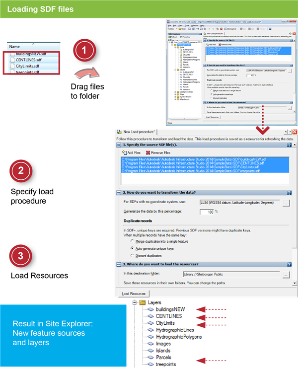

Load SDF or SQLite Files
In this exercise, you add more data source files to the site. Like SHP files, you load SDF or SQLite files by dragging them directly into a folder in the Site Explorer.
  Detailed steps
  1. In Windows Explorer, navigate to the folder: C:\Program Files\Autodesk\Autodesk Infrastructure Studio 2013\Sample Data\SDF.
  2. Select the four files: buildingsNEW.sdf, CENTLINES.sdf, CityLimits.sdf, and treepoints.sdf. Drag the files to the Sheboygan Public folder in the Site Explorer.
  1. In the Load Procedure Editor, select the coordinate system WGS84 datum, Latitude-Longitude; Degrees (in the Category Lat Longs, code=LL84).
  2. For Duplicate Records, select Auto-Generate Unique Keys.
  1. Click Load Resources.
    Note the new feature sources and layer resources in the Site Explorer.
  2. Click FileSave and save the load procedure resource in the Load Procedures folder with the name Load SDF files.
  3. Close the load procedure editor.
