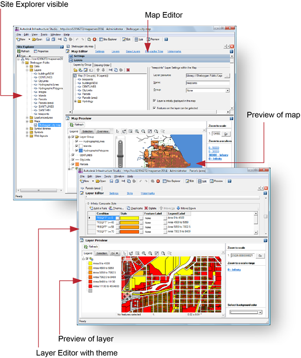

The Infrastructure Studio interface is divided into three parts:
When you open Infrastructure Studio and connect to your site server (via the WebAgent), the Site Explorer shows you the resources stored in the resource repository, as shown in the upper image. Double-clicking any resource in the Site Explorer opens the appropriate editor for that resource. If the resource is a layer or a map, the viewer also opens and displays a preview of the data.
Two views of Infrastructure Studio
