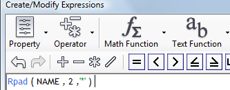

  4. Specify any arguments required by the function, enclosed in single quotation marks.
    For example, if you are padding the right side of a text string with three asterisks, the expression looks like this one:
    For text expressions, the property is within parentheses, followed by any arguments within single quotation marks.
