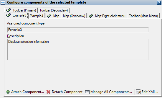

Within Infrastructure Studio, widgets that are dialogs are treated differently from widgets that are run from menus. The widget information file for Example 3, widgets\widgetinfo\example3.xml, contains the following:
<WidgetInfo>
  <Type>Example3</Type>
  <LocalizedType>Example3</LocalizedType>
  <Description>Displays selection information</Description>
  <Location></Location>
  <Label>Example3</Label>
  <Tooltip></Tooltip>
  <StatusText></StatusText>
  <ImageUrl></ImageUrl>
  <ImageClass></ImageClass>
  <StandardUi>false</StandardUi>
  <ContainableBy></ContainableBy>
</WidgetInfo>
The <ContainableBy> element is empty because this widget is a separate dialog and cannot be added to a menu. In Infrastructure Studio, this widget does not appear in the component list for toolbars and other containers.
The template definition file, templates\mapguide\examples.xml, contains a <Panel> element that can hold dialogs or containers:
<Panel>
<Name>Example3</Name>
<Description>The dialog displaying example 3</Description>
</Panel>
By default, Infrastructure Studio places widgets with matching names into the appropriate panel. The panel name matches the <div> ID in the index.html file. If a given template uses a dialog-style widget it must have a matching <div> element. The <Panel> elements create tabs in the Infrastructure Studio UI.

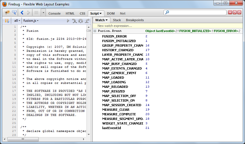

Tip:
For a quick list of available events, open the Script tab of the Firebug extension. Enter Fusion.Event as a watch expression.

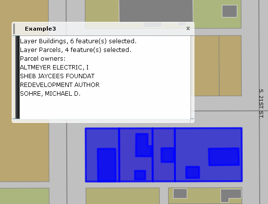

Running the Example
The initialization code for the Example3 widget, in index.html, hides the dialog. There is a menu option to display the dialog, Examples menu Example3. This is defined in the Application Definition as an Invoke Script command that calls the following JavaScript routine:
var showExample3 = function() {
    dExample3.open();
The routine is defined in index.html where it is available to the Invoke Script command.
When the dialog is open it reacts to changes in the selection. Any time the selection changes, the dialog updates to show a list of the currently selected features.
