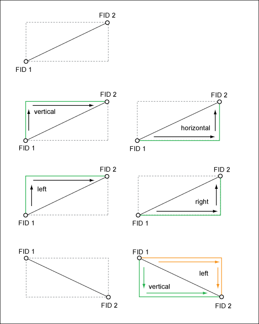

Direction Priority
Applies to Orthogonal schema plans.
Specifies the priority of the direction in which the schematic features are drawn. See Schema Plan Settings.

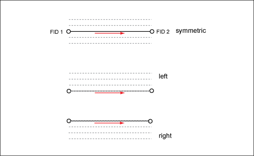

Multiline Distribution
Applies to orthogonal and geoschematic schema plans in the Electric CE module.
See Multiline Offset and Distribution (Electric CE).
Multiline Offset

Direction Priority
For orthogonal schema plans, specifies the priority of the direction in which the schematic features are drawn.
The direction of the lines between two points is derived from the FID. For example, a line will be created from FID 1 to FID 2, either starting vertically, horizontally, drawing the line left to the real world feature, or drawing the line right to the real world feature.
In the Electric CE data model, you can specify the multiline offset and distribution, both for orthogonal and geoschematic plans.
The left or right distribution direction is defined by the FID.
