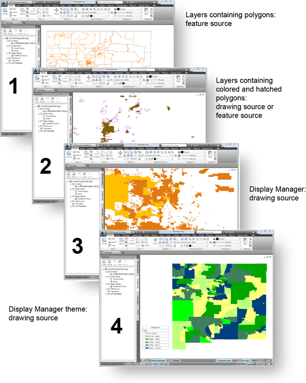

For example, the diagram shows four views of a DWG file in Autodesk Map. The layer containing unstylized polygons (screenshot 1 at top) is converted to a feature source, because it contains simple geometry. The Display Manager styles and themes (3 and 4) already have some stylization, and so they are converted to drawing sources. There is also a polygon layer that has some stylization (2). In this case, you can choose to convert the layer either to a feature source (and lose the stylization) or to a drawing source (and keep it).
Views of a DWG file in Autodesk Map, showing options for converting to feature sources or drawing sources
