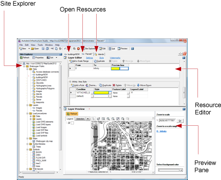

In the Autodesk Infrastructure Studio application window, use the Site Explorer to access the resource repository and the editor pane to define and edit resources.
To work with Infrastructure Studio, you must connect to the site where your resources are stored. The resources on the site are displayed in the Site Explorer. When you double-click a resource, its properties are displayed in the editor, where you can make changes. The features of the editor vary depending on the type of resource you are editing.
The Autodesk Infrastructure Studio interface
You can open multiple resources in the editor pane. Each resource has its own editor. The resource name appears on a tab at the top of the editor. The toolbar at the upper left of the program window contains tools for both the Site Explorer and the various editors. Right-click a site, folder, or resource for additional options.
