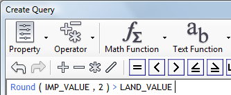

Creating Numeric Expressions
To create a numeric expression
  1. Select the command for which you want to create an expression.
  2. In the expression area, do one of the following:
    • Enter a Numeric Function manually.
    • Click Math Function and select the function you want.
  3. Click Property. In the Property list, select the property for the function.
  4. Specify any arguments required by the function.
    For example, if you are rounding off the length of an item to two decimal places, the expression looks like this one:
