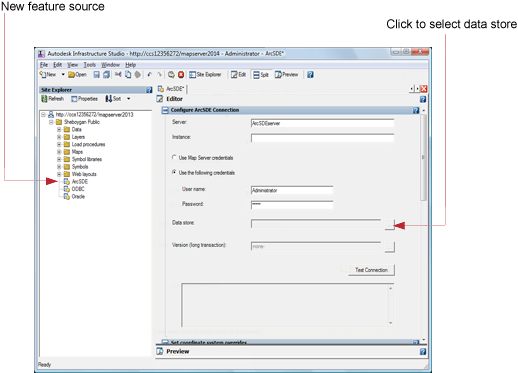

  2. In the Create Spatial Data Source dialog box, select OSGeo FDO Provider for ArcSDE and click OK.
    The Connection Editor is displayed to the right of the Site Explorer.
  3. Enter the server and the instance to connect to.
  4. Do one of the following:
    • If the database is set up to recognize them, select Use Map Server Credentials.
    • If the database requires them, select Use The Following Credentials and enter the userID and password.
  5. Select the data store from the list.
  6. Click Test Connection.
    You should see a Successful Connection message.
