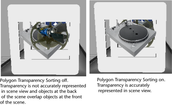

Shading > Polygon Transparency Sorting
Each object's polygons are sorted and drawn from furthest to closest in distance from the viewer. This option provides more accurate transparency representation but may take longer to process.
