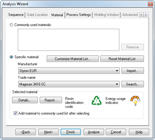

In this task, you select the thermoplastic material used to mold the part, and start the analysis.
Click .
The analysis wizard opens on the Material page.
Select Styron EUR as the Manufacturer.
Select Magnum 3416 SC as the Trade Name.
Click Next to advance to the Process Settings Tab.

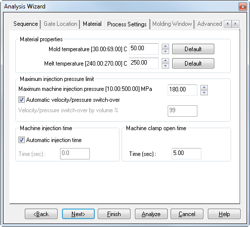

Review the process settings.
None of the settings are being altered.
Click Analyze to start the Analysis.
