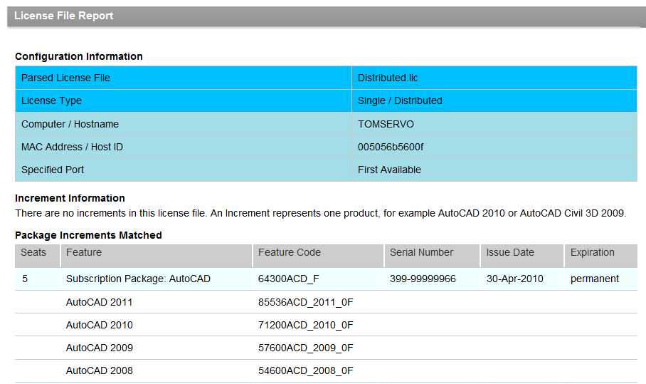

To see the data values in your license file in a more readable format, you can use the License File Parser, located on the Internet at www.licenseparser.com. This utility displays license file data in a table:
Sample License Parser Display
The clear display of product feature codes is especially useful when working with an options file for your network license. Many of the option file parameters require you to specify a product feature code.
