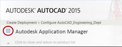

When creating a deployment, you can avoid installing Application Manager by unchecking the Application Manager selection in the installer:
