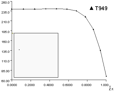

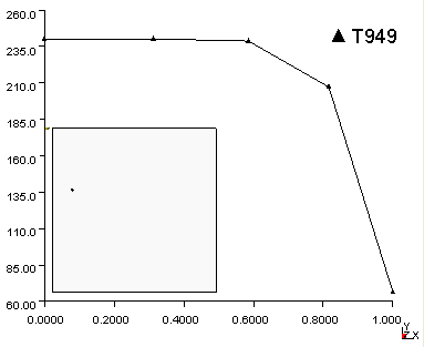

The following figures show the temperature (X) accross the cavity thickness (Y) at a selected location on the part. The number of results shown on the curve obviously increases with the number of laminae accross thickness.
Temperature:XY plot for a part containing 8 laminae accross the thickness of the part.
Temperature:XY plot for a part containing 20 laminae accross the thickness of the part.
