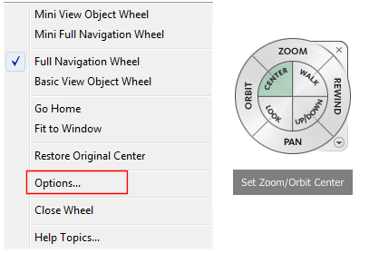

To access this dialog, make sure that you have an active SteeringWheel, then right-click the mouse and scroll down to Options.
|  |  Show Tool Messages  Sets the preference for displaying Wheel messages.
|  |  Show ToolTips Sets the preference for displaying Wheel tooltips.
| Display | Mini Wheel Size Sets the Mini Wheel size to the size of your preference. Big Wheel Size Sets the Big Wheel size to the size of your preference. Wheel Opacity Sets the Wheel opacity to your preference.
| Navigation Options | Look Tool - Invert Vertical Axis Swaps the up-down mouse motion of the Look tool. Zoom Tool - Enable Incremental Zoom-in When Enable Incremental Zoom-In is checked, single clicking over the Zoom wedge increases the magnification of the model, and when left unchecked nothing happens if you single-click over the Zoom wedge.  Walk Tool - Constrain movement to Ground Plane Adjusts the walking movement direction based on your current camera looking direction instead of the default ground plane. It is used in combination with the Look Tool to move around in 3D space.  Walk Tool - Speed Factor Sets the speed for the Walk Tool.
