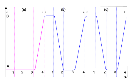

Schematic showing the simulated mold temperature changing during the rapid heating/cooling process
