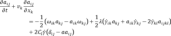

For concentrated suspensions, a term, called "the interaction coefficient" (or  ), has been incorporated in the phenomenological model for fiber orientation proposed by Folgar and Tucker:
 term determines the strength of the diffusion term.
 term determines the strength of the diffusion term. Adding the rotary diffusion term to account for the fiber interactions has been found to improve the orientation predictions, since Jeffery's equation alone does not give qualitatively accurate predictions for fiber orientation.
Until now, the Folgar-Tucker model has been the best available for fiber orientation modeling in concentrated suspensions. The model has been given in this form by Advani and Tucker:
where:
 equals 3 for 3D and 2 for planar (2D) orientation
      equals 3 for 3D and 2 for planar (2D) orientation  is the velocity component
           is the velocity component  is the vorticity tensor, and
                         is the vorticity tensor, and  is the deformation rate tensor.
 is the deformation rate tensor.  is a constant that depends on the geometry of the particle
      is a constant that depends on the geometry of the particle  is a unit tensor
               is a unit tensor  is the interaction coefficient
           is the interaction coefficient The tensor form of the fiber orientation model from Advani and Tucker is not yet a suitable derivative for a second order orientation tensor, because it contains the fourth order tensor  .
The derivative for a fourth order tensor contains a sixth order orientation tensor and so on. The only way to develop a suitable derivative is to approximate the fourth order tensor in terms of a second order tensor.
This approximation is called a "closure approximation". Various approximations have been tested by Advani and Tucker. However, the presence of the approximation itself may introduce some error into the simulation results. So the closure approximation is the most challenging problem associated with this model. No value of  can make the fiber orientation model expression fit all the orientation model components.
