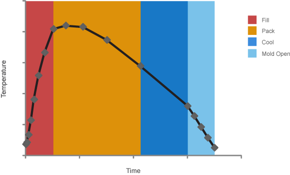

Change in temperature of mold during an injection molding cycle
During the filling stage the high temperature molten plastic is injected into the mold cavity at high pressure. This causes the temperature of the mold to rise. Following injection, the molten plastic cools down as a result of the cooling channels in the mold, until it reaches a cool enough temperature that the plastic part can be ejected from the mold at the commencement of the mold open stage. As a result, the temperature in the mold also decreases. As shown in the graph above, therefore, the mold temperatures rise during the filling and packing stages but drop during the cooling and mold open stages. The transient cool solver can be used to simulate the mold temperatures at different stages of the injection molding cycle.

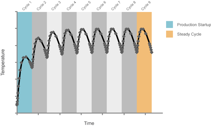

Change in temperature of mold from one cycle to the next during a production start-up routine
When an injection molding machine is commissioned to manufacture a product, it may require many cycles before the mold reaches its optimum operating conditions, or stable cycle. Once the stable cycle has been reached, the mold temperature within a cycle still changes, as shown in the transient within cycle graph, but is constant between cycles as shown in the graph above. Until the stable cycle has been attained, the quality of the part cannot be guaranteed. The transient from production start up solver simulates the process leading up to the stable cycle and helps predict how many cycles will be required.
