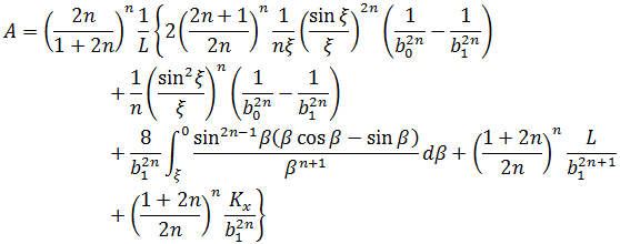

For a typical QFP chip, openings in the leadframe exist at the corner, side and periphery of the chip, as shown in Figure 1 below. In modeling the openings for Fill+Pack analysis using the Hele-Shaw approximation, we need to consider the juncture loss associated with the flow across the openings. Because of the juncture loss, the modeled openings will not be the same size as the actual openings. To calculate the size (thickness) of the opening to be used in the model, use the equations below.
where
and
when
when
when
where:
is
is the power-law index,
is half of the opening width,
is half of the distance between the solid region,
is half of the opening width to be used in the model. The length of the opening in the model can be used as the thickness of the leadframe. For the periphery around the chip (as shown in Figure 1 below),
can be assumed to be half of
and
is the thickness of the leadframe. When
=0.74,
= 1.2041,
= 0.2501 and
=0.903. The values of
and
only slightly depend on
, so these values can be used for other values of
. For approximation,
can be taken as
. The integral term in equation 2 can be approximated by :
