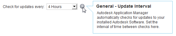

Note that some settings have an information (i) icon where you can hover your cursor to see a tip panel that provides further explanation of the setting.

General Tab
These settings control automatic startup, and the frequency of checking for updates.
