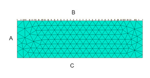

Midplane models
For Midplane analyses, the elements of the model are selected and assigned the property type "compression surface". The nodes associated with these elements are then considered to move with the press plate.

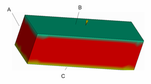

Automatic assignment of model surfaces
Compression surface property result
where A = side surface, B = compression surface, and C = fixed surface

- In some cases, particularly with complex geometries, poor mesh quality, or special, proprietary processes, the assignment will need to be refined. In these cases the three compression surface types, shown in the figures above, can be assigned manually.
There are four (4) compression surface property options:
- Automatic
- The determination is performed by the code. This is the default setting.
- Compression (moving) surface
- The compression (moving) surface is considered to be the press side of the cavity and will follow the press movement exactly.
- Fixed surface
- The fixed surface is considered to be the fixed side of the cavity. No movement occurs during compression.
- Side surface
- The side surface is illustrated by A in the figure above. There is no movement of nodes with this compression surface property in the direction normal to the compression direction, but there can be movement in the compression direction.
