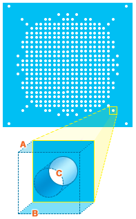

For example, consider the following case shown below, where one cell is taken around a solder from the array of solders to consider the surface area around that solder:
There are three areas related to this cell:
-area around the solder in the upper region (not including the solder region).
-area around the solder in the lower region (not including the solder region).
-surface area of the solder. For this case, the shape factor is =
If the length of the cell (assuming square cell) is
and the diameter of the solder is
and the cavity thickness (which is the same as the solder height) is
, then:
