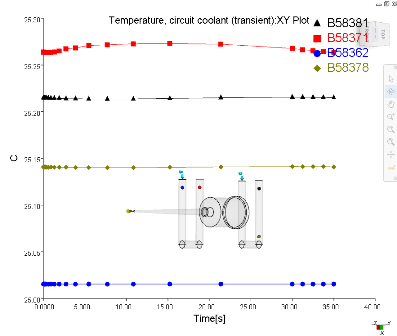

The Temperature, circuit coolant (transient) result shows how the temperature of the coolant in the cooling channels changes over the duration of the cycle.
Use this result to determine whether the cooling channels are cooling effectively, and whether their placement will affect cycle time and part warpage. If there are hot or cool spots, you may need to adjust the cooling channels, or coolant temperature. Cooling channel placement and the thermal conductivity of the mold will affect the temperature variations.

When viewing the Temperature, circuit coolant (transient) result, watch for the following.
