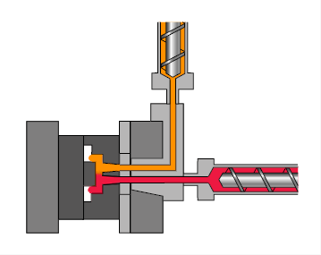

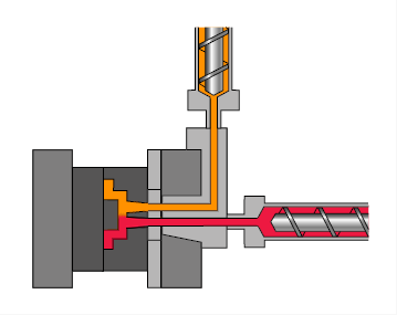

A bi-injection molding process involves injection of two different materials into a mold at separate injection locations, which are controlled independently by two different injection units.
Bi-injection molding process
.Material A and Material B are injected through separate nozzles. A weld (or meld) line forms where the two materials meet.
