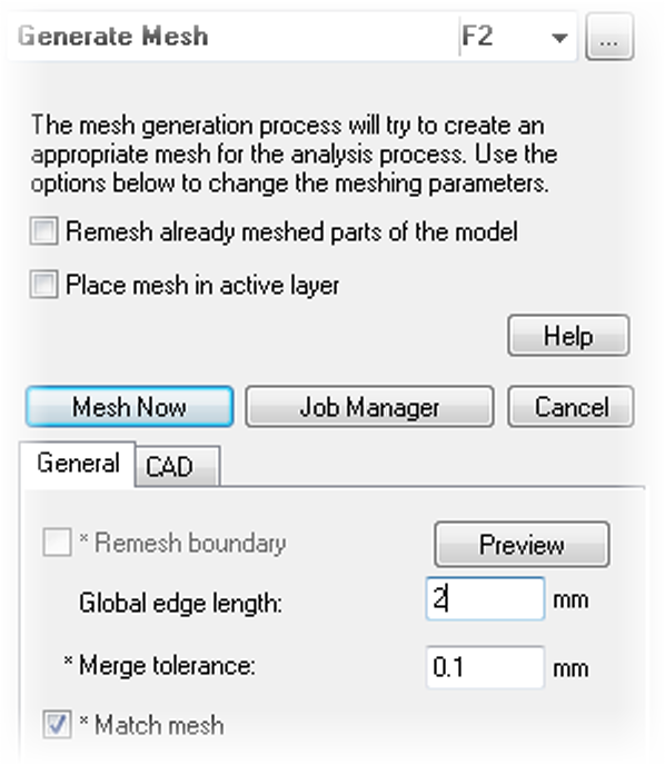

In this step, you create a Dual Domain mesh on the imported CAD model.
Click
() to display the mesh tab.
Click
() to display the generate mesh panel.
Enter 2 (mm) as the Global edge length , then click Mesh Now.
When the mesh is finished, click Logs at the bottom of the Synergy window to close the Logs Panel.

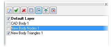

Deselect the New Body Nodes 1 layer in the layers panel.
